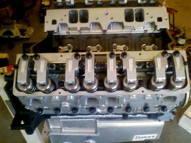

She's slowly coming together.
It's been a several month ordeal, but finally I've gotten motivated.
Drill and tap the manifold for the injection, and plumb the vacuum pump and she's ready to dyno :D

Postby FuelieNova » Mon Aug 02, 2010 1:49 pm
That's looking nice. I got one on the engine stand right now but it is a street engine.

Postby Andy Hunt » Tue Aug 31, 2010 6:40 pm
This particular project has taken way too long, but the end is in sight. They say good things come to those that wait, guess we'll find out next week when she hits the dyno.

Postby Chad Speier » Sun Sep 05, 2010 10:27 am
Looks good, keep us posted!
I like the pan!! Charlie is the man!

Postby Andy Hunt » Wed Sep 22, 2010 8:43 pm
Friday's the day I finally get this b*tch on the dyno.
A little info:
452" SBC, 4.175x4.125
14.9: CR
278/287 @.050 110LSA, .450/.435 LL, 107.5 ICL
1.8:1 rocker
Edelbrock 2858 manifold
Injected alcohol
Brodix 12x12RI cylinder heads, 3.17 MCSA
.200 169.0
.300 243.6
.400 300.3
.500 346.5
.600 376.9
.700 388.4
.800 398.4
.900 401.4
1.00 404.0
Andy Hunt
Posts: 57
Joined: Tue Jan 22, 2008 4:49 pm

Postby Andy Hunt » Fri Sep 24, 2010 7:58 pm
Made it back from the dyno.
The little motor did good.
871.3hp @ 7400
690.6lb/ft @ 5900
I'm really surprised at the torque output! She averaged 839hp and 650tq from 6000 - 7600. It made 805hp @ 6000!
Best pull came with .038 nozzle and .082 pill with 32* timing. 0 1/2 pump.
The other engine ran best with .038's and .092 pill. I've had great luck with the gold pump. That particular one's been on the car since 2000.
So, what's it gonna run @ 1650lbs?
