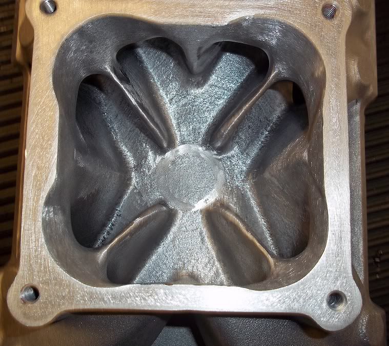

Postby Chad Speier » Sat Jan 15, 2011 2:34 pm
The blended parts are 60 grit. Everything else was just finished with a double cut burr.
John, the circle is a funny thing. I caught some grief one time using the standard diamond. Just looking for something "different". The shiny came from a 60 grit sanding disk. It fit perfect and woundn't allow me to move it around and it made a circle.

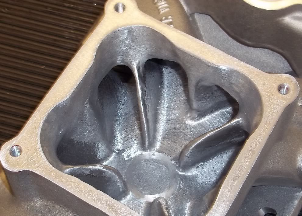

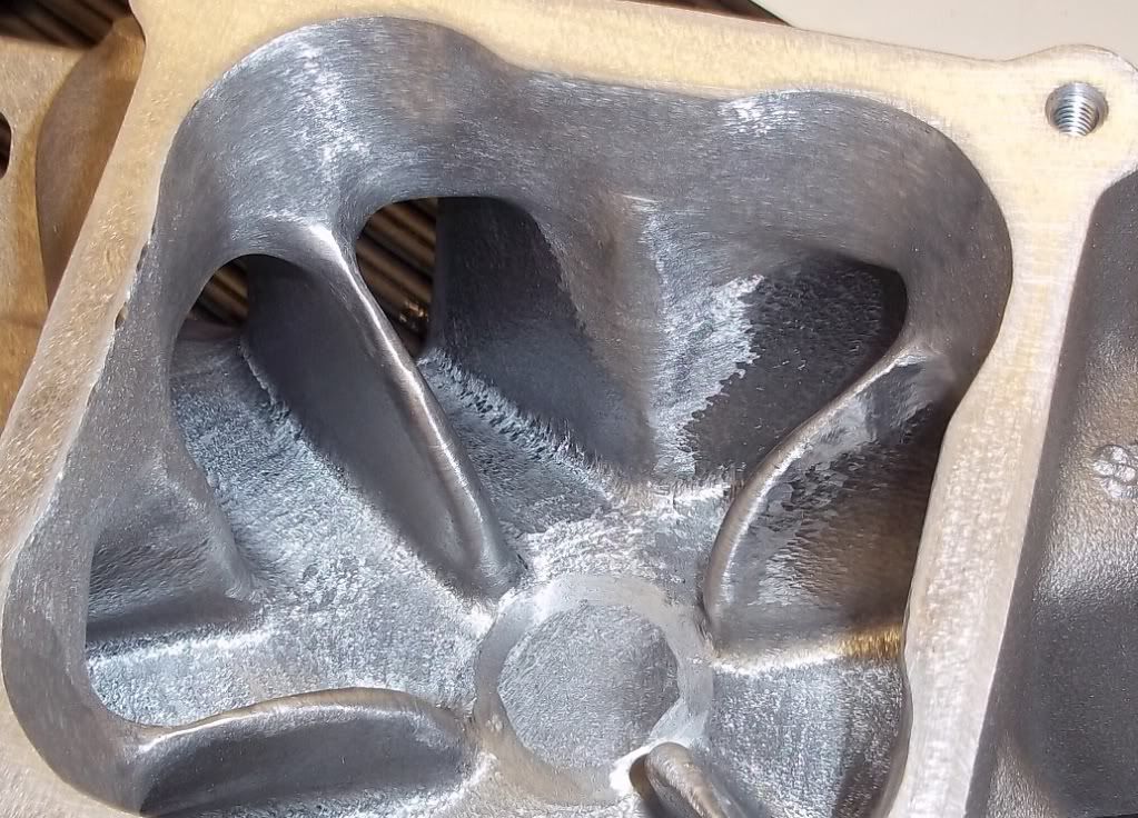

Postby redsmokin57 » Sun Jan 16, 2011 1:51 am
This last picture shows it more clear, but is the very top of the port divider deliberately sharper than the rounded bullnose for the rest of the divider? I've read the posts where knife edge dividers get a bad rap from the majority, just curious?

Postby Chad Speier » Sun Jan 16, 2011 12:59 pm
redsmokin57 wrote:This last picture shows it more clear, but is the very top of the port divider deliberately sharper than the rounded bullnose for the rest of the divider? I've read the posts where knife edge dividers get a bad rap from the majority, just curious?
Cheers Steve
Yes, trying to influence the air.
