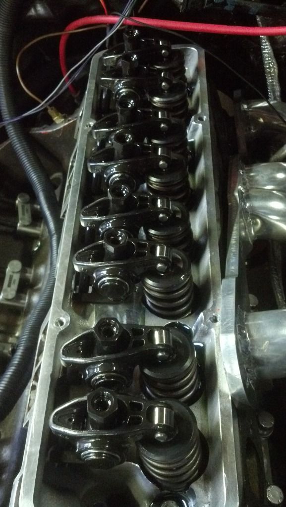

ok so got in there to measure my pushrod length. looks like i need a rod 7.350" long. this photo is taken with the scorpion 1.6 roller rockers with 1/4 turn preload from zero lash
pattern looks pretty darn good to me at 7.350"
heres the same but on a diff cylinder
7.300"
7.250"
wear on valve tip from pushrods that machinist installed ( i measured at 7.8") key not the rocker arm could not move in full due to it binding on the poly lock hence the broken studs

Okay so switched to a 1.6 ratio comp ultra pro mag rocker which changed pushrod length to 7.300". cleaned everything up, installed new 7.300" .080" wall thickness chromemoly hardened 1 piece pushrods along with my comp ultra pro mag rockers. Valves adjusted, top end getting buttoned back up. Need to re prime oil system and fire it back up. hope to do so very soon.
today:
WooHoo she lives again!!!!!!!!!!!!!!
after work today i primed the oil system once again and stabbed the distributor in. Got it right on the first try lol. fired it off and man does it sound good. no broken parts this time with the right pushrod length.
