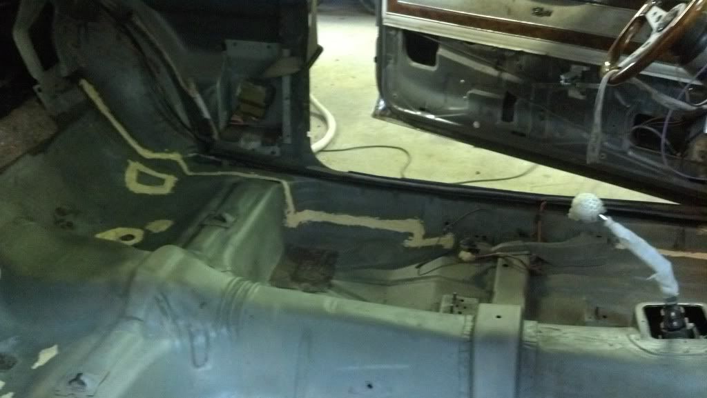

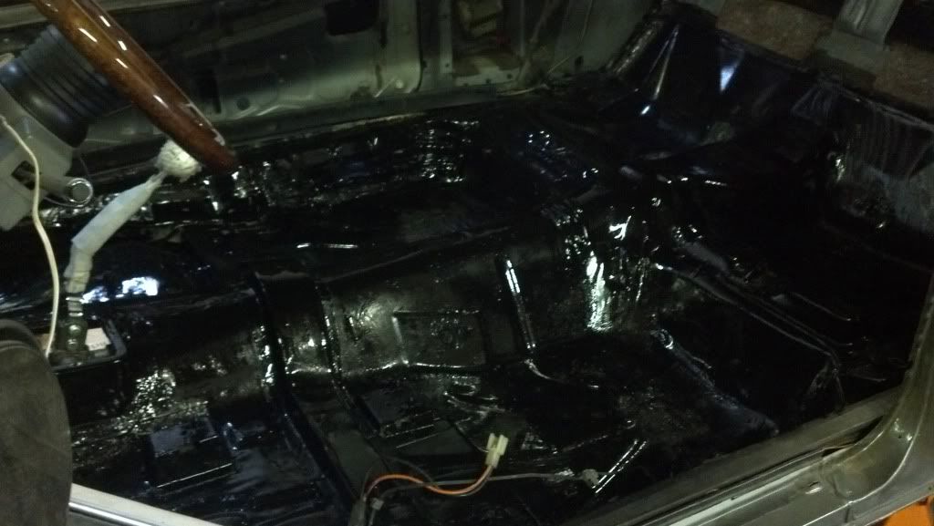

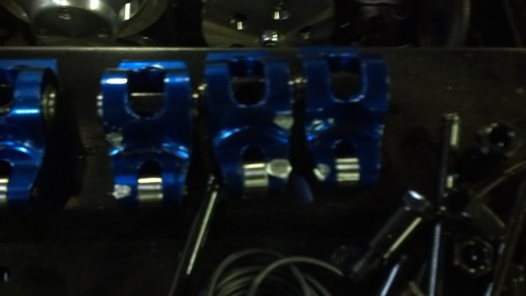

well today started off great. got all my welds grinded down and the whole floor self etched then seam sealed. ruberized undercoated the underside and painted the topside. looks great. then i filled up all my fluids, primed the oil system and lit off the motor. all was well and about a minute in it started making a loud pop noise so i shut it down. pulled the valves covers and it broke 5 rocker studs, broke 3 pushrods, and bent the other 13 also chewed up some rockers. its wierd because it was running rather well i thought for nothing being adjusted yet. i checked the dist and it was a little loose. what could have caused this? i need to pull the intake so i can get a broken pushrod out of the lifter valley. any input would be great.

ok so im hoping this is simplier than what i originally thought. upon further inspection of the rockers and the poly locks i notice there is a nice wear mark on the body of each rocker slot and a matching mark on the shoulder of each poly lock. this leads me to believe that the pushrods were too long and causing it to bind up. im guessing the lifters werent all the way pumped up when i was adjusting and it masked the problem. on a good note my machinist/friend is covering the cost of the new studs, shorter push rods and intake gaskets. im hoping its this simple as it seems to make sense. if it was piston to valve clearance i would have thought you could here the valves smacking the pistons.

I think your correct. It sounds like the pushrod was too long and it jumped out of the cup.

Also would you trust the rockers? All rollers are free and not mared. Just the bodys of 3 or so. Nothing a little deburing wouldnt solve but do you think they have integrity still?

The rockers probably were not hurt.
